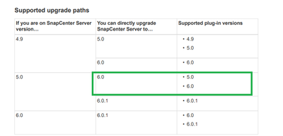

Yes, you can upgrade SnapCenter to 6.0 and keep the plugin 5.0P2 Servers running Windows Server 2008R2 and 2012R2.
Refer to the SnapCenter 6.0 release notes under section: Supported upgrade paths : https://library.netapp.com/ecm/ecm_download_file/ECMLP3323468

Thank you very much @PravinKumar ! I had seen that in the documentation, however the IMT provides inconsistent information. As I said:
I say possibly because the online documentation and IMT for the plug-in say the SQL 5.x plug-in is compatible, but the IMT for the server says it is not
So even though the documentation says it should work, the IMT indicates specifically that the SQL 5.x plug-in is not compatible. I'm guessing that's likely inaccurate but don't know for sure. That's what I'm trying to find out in this post.

Hi Tim,
Please find the IMT report attached for  Snapcenter 6.0 with Snapcenter plugin for SQL 5.x , it confirms supported.
All are different versions from 6.0 -> 6.0.1 -> 6.1.  P1 patches are respective patches for those specific versions. Yes release notes covers the P1 patch details.
Please let me know if you have any further queries.
