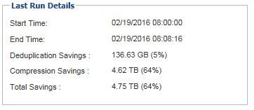

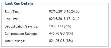

we are in the process of moving data from FAS 2240 7-Mode 8.2 to FAS 8020 Cdot 8.3. This is all CIF shares.  On our old 2240 we are getting some realy good savings with Dedupe & compression. I'm using Robo copy to move over the data. Once the data is copied overto the  new FAS 8020 I'm getting no where near the savings that I was getting on 2240. It's the same data on each of the volumes I could live with and understand a small veriation but this is huge differance. It's also not consitant across all of the volumes that I have copied over some are getting better savings.

Thanks for your help, after the weekend I did see some more savings but stil wasn't what I had on my other system. So I pretty much started from scatch. Deleted Snapmirror relationship, deleted volumes. Recreated volumes, recopied the data and let the schedualed dedupe and compression cycles run. So far on the volumes I have done this I'm getting at least equal amount of savings from Dedupe and compression.
