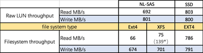

Customer has done tests today:
  • create partition before make filesystem -- just follow a NetApp KB
  • Added ext4 for comparison
  • Used SSD LUN for comparison
Please find results as below (block size 128K):
  • No big difference between XFS and Ext4
  • It is interesting that read throughput (on XFS) increased to 139MB/s when customer did the read test 2nd time, compared to 75MB/s at the 1st time
  • In contrast, read throughput was close to write when customer did the same test on SSD LUN
Any thoughts?
