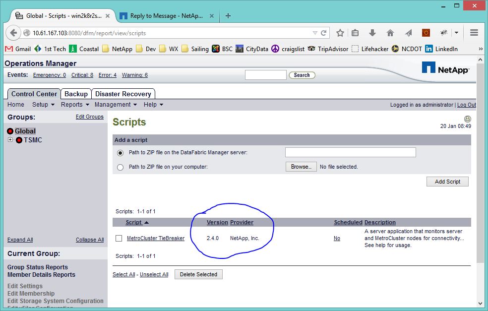

How to check the version?  I run mctb version but return deamon version.  How to check the mctb version (2.2 or 2.4)?
abrian
4,919 Views
You can see the version under the Operations Manager->Maintenance->Scripts menu item:
