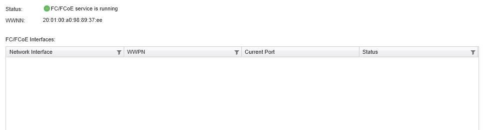

i have a fas2554 with ontap8.3p1 installed
in this i have 4 x fc apaters

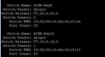

so far i have connected 1 adapter to an fc switch
this apprears to be working as it can see the switch
i have then created a svm, but the adapter list is empty, how do i fix this?
1 REPLY 1
adencool
2,435 Views
fixed it?
needed to create lif's for each interface!
