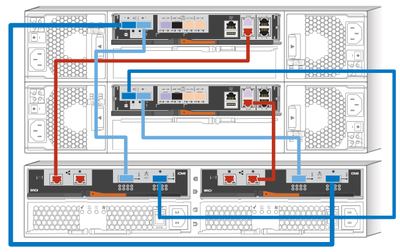

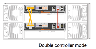

I have a FAS2554 HA system in production with internal shelf with SATA disks. Connection as in a manual:

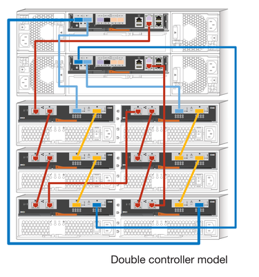

I want to add a new additional shelf DS2246 with SSD disks, but I don't understand some moments. In a manual it is written:
1) I can hot-remove SAS cables?
2) On the picture connection of the full stack. How to connect only one shelf I don't understand.
3) I shall switch off ACP before?
4)
the correct scheme will be?
Thank you!

On the last picture there is no cable connecting the ADC channel connected between the modules of the shelf. The rest of it right.
