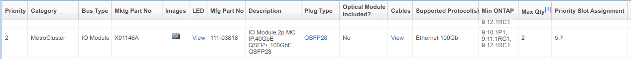

About the A900 and FAS9500 MCC IP configuration, the priority slot assignment is 5,7 in HWU.
In MCC IP installation guide, e5b and e7b are used as metrocluster interface, which means e5a and e7a are not used.
Is that possible to use 1 card and both ports like A700? Instead of using 2 cards.
If not possible, what is the reason behind it?
