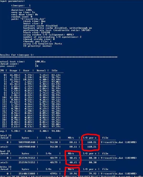

A normal Full Backup Job only backup ( Writes ) with 144 MB/s to the backup Storage FAS 2554  . An Merge Job ( Read and Write ) needs needs very long time and the Creation of an virtual Full to Tape needs for 10TB 41 Hours with 70 MB/s on an LTO5 Tape Drive via SAS.
What can be the Problem for poor Performance on Writing or Reading from an W2008R2 Server to the FAS2554 ?
Which Speed should be able with an 10Gbit ISCSI Connetion from an Windows Sever to the FAS 2554 ?
Here an Speedtest from the Server to the Storage with Diskspd Tool :
Can MPIO an Solution ?
