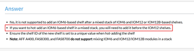

Hello,
      as per this document(https://kb.netapp.com/on-prem/ontap/OHW/OHW-KBs/How_to_cable_an_IOM12E_platform_with_IOM6_and_IOM12_storage_shelves_in_Multi-Path_HA ), FAS2720 with embedded shelf need meet strict rule when using a mix IOM6 & IOM12 stack. The above document only states that a new cabling installation is permitted. Is it possible to hot-add a DS4246 to FAS2720 with a DS212C in a stack?(refer to the cabling figure below) I didn't find the document about. Please advise, thanks a lot.

I tested the above cabling method, It is supported to hot-add a DS4246 to a existing DS212C stack on FAS2720
https://kb.netapp.com/on-prem/ontap/OHW/OHW-KBs/Can_I_add_an_IOM6_at_the_end_of_a_mixed_stack_of_IOM6_and_IOM12

Just be mindful that ONTAP support for all SAS2 (IOM6-based) shelves is removed starting with ONTAP 9.16.1.
