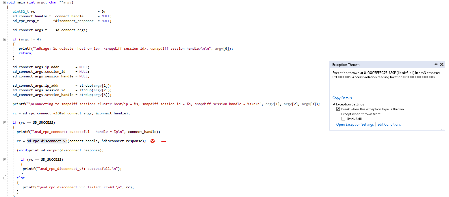

I am trying to prototype using the version 3 snapdiff api and have been running into access violations, etc.
I am using Visual Studio 2017 (and building x64) and I have built the x64 version of oncrpc.dll .
I have successfully issued the REST api's to generate an access token from the NetApp supplied license, and have also been able to issue the REST api to start a snapdiff session and return a session id and handle.
My code calls sd_rpc_connect_v3 with cluster ip address and session information from the rest call, and it succeeds and returns what appears to be a valid sd_connect_handle_t handle.
My problem is that calling any rpc calls with this handle (even sd_rpc_disconnect_v3) throws an access violation exception.
I believe I followed all of the instructions in the SDK documentation and I am using SDK DLL's and libraries in  lib\nt\x64\VS22.
This is the exception I consistently am getting:
Again, the connect appears to be successful and does return what appears to be a valid handle.
Any insight or suggestion would be greatly appreciated ....

PeteTanenhaus
3,236 Views
The RPC server is turned on and as mentioned above, the rpc connect is successful and returns a handle, but subsequent rpc calls with the handle throw an exception.
