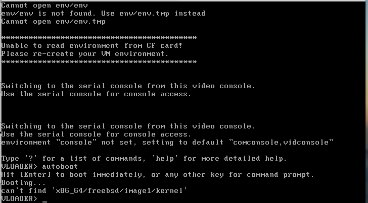

As a test, I had a 3rd 83rc1 vsim which I shutdown and used Fusion Setting Compatibility to upgrade to current which turns out to be VM-HW version 12. That vsim will no longer boot but instead gives the error shown below. Questions:
 Q: Does anyone know if this can be fixed or should I burn it and start over?
 Q: Does anyone know if upgrading an 83 vsim to Fusion 8.0's VM-HW version (12) at the start of a vsim install process would work better?

SO from what I see there, the loader can't find the kernel or the env file.  This makes me think the drive ordering has changed.
From the loader can you run "lsdev" and post the output?

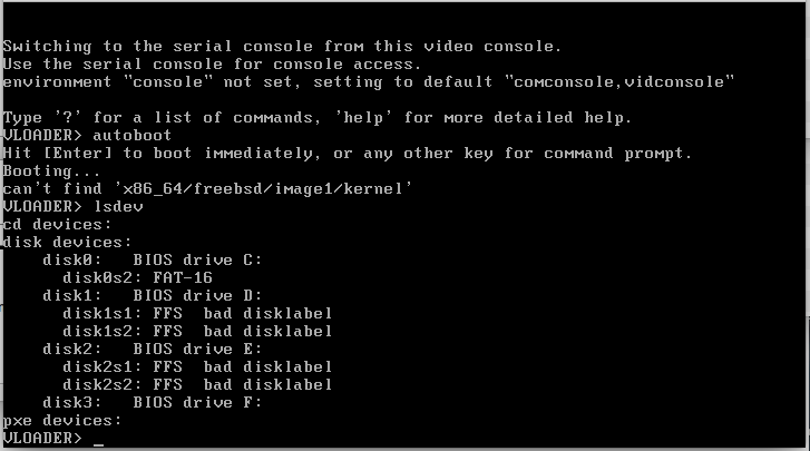

It should resemble this:
VLOADER> lsdev
cd devices:
disk devices:
    disk0:   BIOS drive A:
    disk1:   BIOS drive C:
      disk1s2: FAT-16
    disk2:   BIOS drive D:
      disk2s1: FFS  bad disklabel
      disk2s2: FFS  bad disklabel
    disk3:   BIOS drive E:
      disk3s1: FFS  bad disklabel
      disk3s2: FFS  bad disklabel
    disk4:   BIOS drive F:
pxe devices:
The kernel, ontap image, and the env file are on the fat16 volume on disk1s2.  If that volume appears to be on a different disk number, it won't be able to find it at boot.

I'm no expoert on stuff at this lvel but I think you're right. Here is my lsdev from that vsim (different from yours). I wonder if this is salvagable or I should just burn it 🙂

I think we can fix it.
Since drive A is missing, see if the VM has a floppy drive.  If not, add one and try it again.
If it still doesn't work, point the floppy drive to a blank floppy image.
If that still doesn't work, we can change the pointers so it looks for disk0, but one of them is hard to get to.
