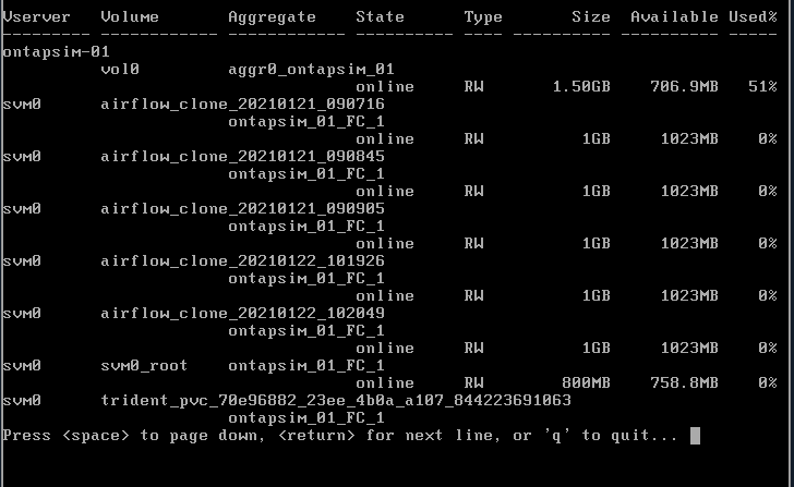

Thank you for your comment, I expand the vol0.
Yesterday's error screen shot is follows.
After I met following error, I do disabling root snapshot  and  expanding the root volume size.
Previously the vol0 size is 800MB, currently I update to 1.50GB.
Also svm0_root is 20MB previously, so changed to 800MB.
Current volume sizes are follows
shypervisor
7,038 Views
Thank you for your advice. It works fine even it passes weekend.
