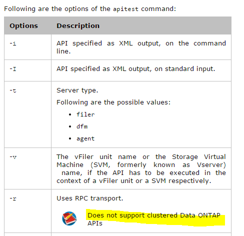

georgevj
5,880 Views
from documentation, FYI.

anton_oks
5,865 Views
Thanks georgevj.
Well, strong indicator that it is not working, confirmed, but it's the APITEST docu only 😉 So in theory it could be that only the tool doesn't support it, right 😮
