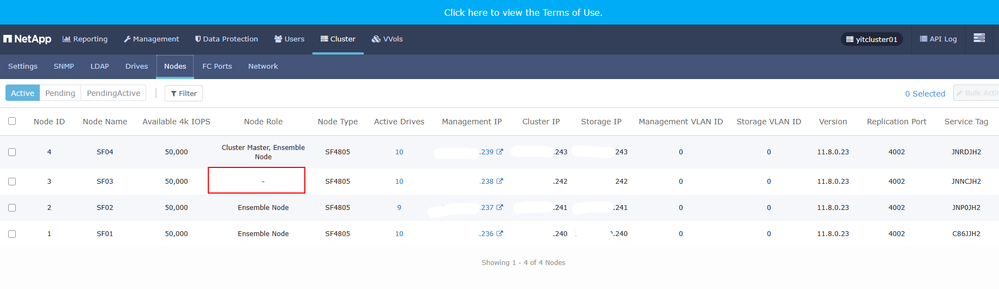

"I restarted Node 3 and successfully re-added all disks. It is operational, but I'm wondering why it hasn't joined the cluster and why there is no Node Role assigned to it."
elementx
7 Views
I did join the cluster, it just doesn't have a cluster-related role. 🙂
If you look at its IO stats (https://github.com/scaleoutsean/sfc,  if you have nothing better), you'll see storage services are very much alive. Any member may have an active cluster role if required. In a 3 and 4 node cluster 3 are ensemble and 1 is master. Since that node went down, the other 3 now have ensemble role. If you had 5 nodes, all 5 would have ensemble role right now.
Try and reboot some other node and you'll see it'll get a role or two... But - given the flakey nature of that node's h/w - it's better to not play games 😉
