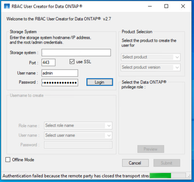

Hi,
I was able to install RBAC User Creator for Data ONTAP 2.7 on windows 10 computer, but keeps on getting error:
The windows desktop has full access to netapp management network and I can access the system manager from windows desktop. Please advise what can be causing and possible fix on RBAC error.
Thanks,
Pandoy

Thank you for look into this.
I have checked the ssl status for cluster SVM and the expiry date, both looks good (Server Enabled is true and Expiry is set next year). But I renew it too trying to see if that will fix it.

ONTAP System Manager looks good when access via gui, but I am still getting the same error when running RBAC

I see the same issue.  The cert is not expired and SSL is enabled.  Any thoughts?
