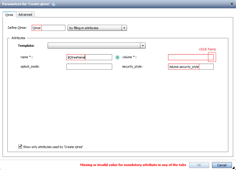

Enter a name for the command variable EG "Qtree" and in the "name" parameter enter "$QtreeName". In the security style you can enter 'volume.security_style' (assuming you want the Qtree to be created with the same security style as the volume or you could enter "$SecurityStyle" if you want that as an input). In the volume paramater click the right side. EG

Enter input variables to filter the volume:
Click ok and yes to update variable references then save your workflow.
