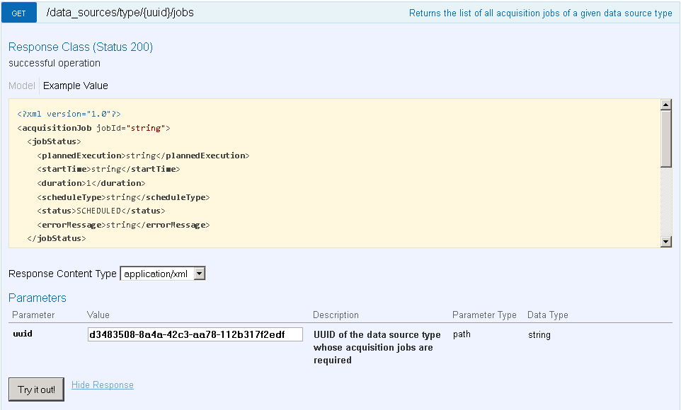

Check the Swagger interfact for browsing the WFA REST API's using your browser:
https://<%wfa_server%>/rest/docs/
You first need to find the UUID of the datasource using:
https://<%wfa_server%>/rest/data_sources
find the datasource by name then get the UUID and pass that into the following URI.
https://<%wfa_server%>/rest/data_sources/type/<%uuid%>/jobs
If you click the "Try it out" button you can view the aquisition job and status for that datasource.
EG for my environment the URI is:
https://wfa.testlab.local/rest/data_sources/type/d3483508-8a4a-42c3-aa78-112b317f2edf/jobs
