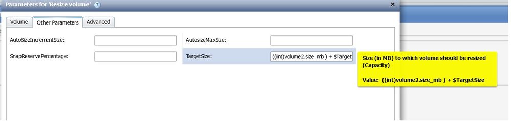

For creating customized workflow for Resize volume please follow the below steps:
1. Search and define should be done for volume dictionary.
2. For TargetSize Instance, MVEL expression as mentioned here: ((int)volume2.size_mb ) + $TargetSize (Attached is the screenshot for reference)
3. Resize volume command, TargetSize should be provided in MB(if one GB need to increased please provide as 1024)
For more details please let us know, we will have WebEx disucussion.

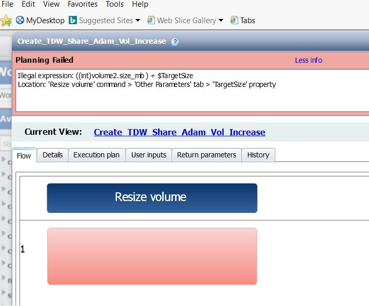

I just realized I think I should be using the 'TargetSize' parameter. I am able to put a final size of the volume successfully, but I want to increase the volume size by a user input amount. I tried using volume1.size_mb + $Size, but I get error:
Illegal expression: volume1.size_mb + $Size
Location: 'Resize volume' command > 'Other Parameters' tab > 'TargetSize' property
Anyone know the syntax here?

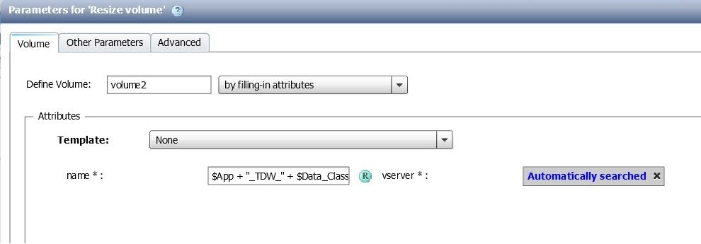

A_Campbell
9,149 Views
I am still getting the illegal expression error. See attached screenshots. I believe my volume selection should be working fine because if I have user input only as final target size, I'm able to resize the volume successfully. But, seems to be failing on illegal expression with ((int)volume2.size_mb ) . Thanks for the assistance, I can do a webex if you like.

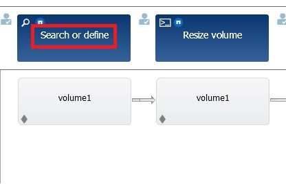

A_Campbell
9,006 Views
The solution above resolved the issues. The reason I continued to get the error initially is because I wasn't following the first item in the instruction, using 'search or define' to define the volume being resized. Once I fixed that by adding the command shown here, everything worked perfectly.
