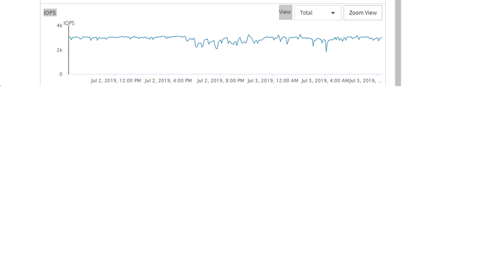

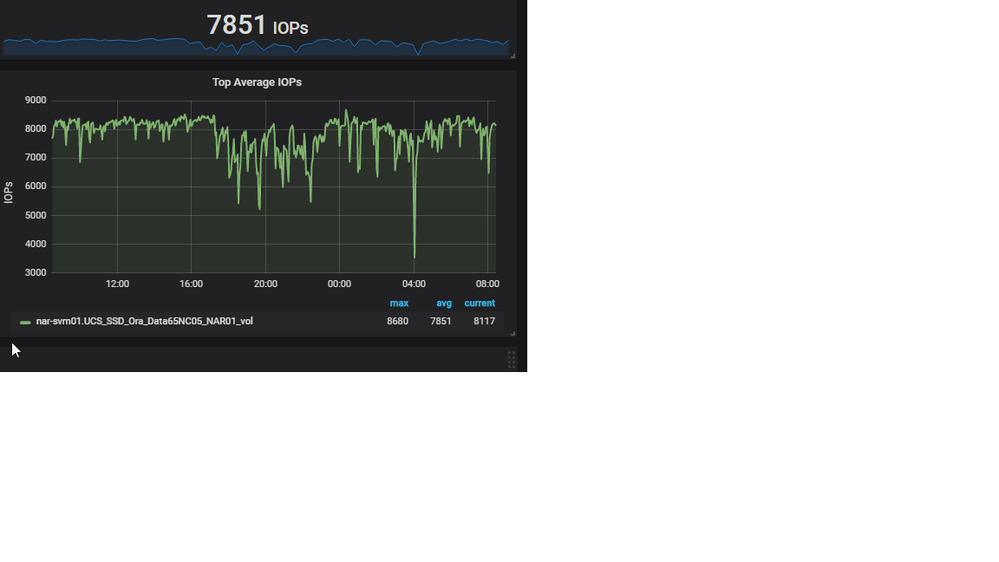

We've only had grafana setup with harvest 1.4 for a little while and I'm noticing a difference the iops for volume seems way off compared to ocum. For example I have one volume thats showing anaverage of 7.7k iops over the last 24 ours, but ocum sees an average of 2.5k iops over the last 24 hours. I'm trying to figure out which one is correct, I would think ocum, but I have a qos policy on this volume and it seems to be pretty close to the 8k max iops policy I have set.

vachagan_gratian
16,732 Views
The difference is indeed too large to be neglected. Could you maybe send me a sceenshot of both dashboards? I'll try to investigate this when I find a bit of time.
zenmatrix83
16,719 Views
zenmatrix83
16,723 Views
Thanks, even the drawn out lines looks similar they are just about 5k off.

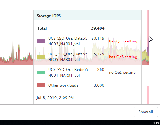

zenmatrix83
16,605 Views
I'm wondering now if we have something wrong, I saw a large workload just start. In the top average iops show as almost 20k in grafana, but in ocum and vmware they only show around 2k.
zenmatrix83
16,604 Views
Never mind ocum in another screen shows the 20k, now I just need to figure out why my qos policies aren't working.
