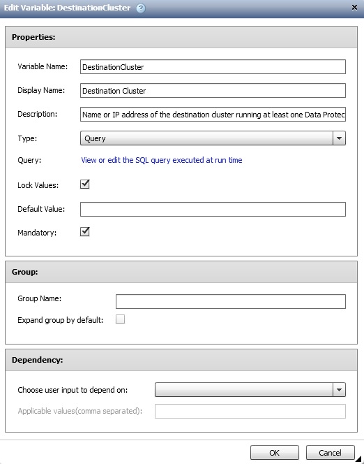

I'm using WFA 4.0 and OCUM 6.4RC1.  I guess WFA 4.0 doesn't support the "Inventory" option as I didn't see it available.  There are no errors on the Execution Data Source for OCUM as you can see below.  For all of the built-in workflows that have a "Cluster" field, the clusters seem to populate just fine.  Maybe the problem is that the field is "Destination Cluster" instead?  Would you recommend WFA 4.1 as an upgrade?

The "Destination Cluster" is just a label on the User Input screen, so don't read too much into that.  To figure out exactly what the SQL query is behind this input, you will need to go to the "designer" tab and select the workflow and edit it.  The User input tab will list all of the inputs and you can select the "evaluate at runtime" to see the actual query.  It is most likely name or primary_address from cluster.cm_storage.  You can test the query on this screen as well.

It looks like the Values column shows "evaluated at run-time".  I can double click the field and it opens up to this.

Sorry, you need to select the "View or edit the SQL query executed at runtime" to see the SQL code.  I am also importing the pack from the automation store, so I can see what it is doing.
