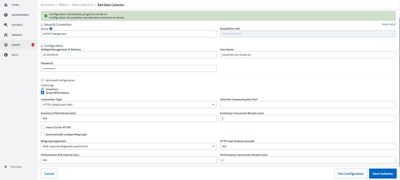

What error is this?
Internal error: Cannot update server (Failed to execute the http method for request https://0da44afd-4051-474e-8a1e-5ab17b9f33ed.c02.cloudinsights.netapp.com/compose/originatorUpdate/SANSCREEN/2 500 error is Internal Server Error)
I've been getting pretty generic 401: Not Authorized or Inventory Failed from the ONTAP Data Collector. Sometimes the Test Config succeeds and sometimes it fails to execute test command on device without re-entering the password. I can log directly into OnCommand on the FAS and all the appropriate services on the Data Collector VM appear to be running.
Edit: Just got another 401 error: Invalid login credentials: 401 Unauthorized.

I'm running CI. I checked my credentials first thing and the correct permissions are set, I can log directly into the FAS as an admin. I had the lab admin elevate my permissions to full admin to double check.
The first image below is the error. The second is after I enter in the password to test and the third is after I run the test again with no changes. Even after that, it's not sending data. I do get information from ActiveIQ.
As near as I can tell, the data collector service is running on the VM in the lab there is also an Aquisition Unit running on the same VM and it reported OK 13 hours ago.
Could this be related to my license level? At the moment, it's at Basic until I can get my final lab license.
Thanks!
Annotation 2019-11-28 111255 1.jpgAnnotation 2019-11-28 111255 2.jpgAnnotation 2019-11-28 111255 3.jpg
