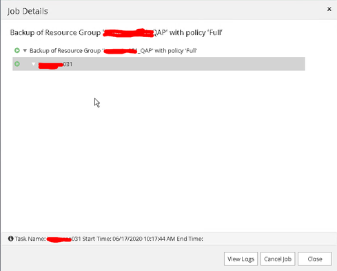

If I start an oracle snapshot instead, not even a connection-Attempt towards the host could be seen.
This is all i see:
and the job keep hanging on server.
