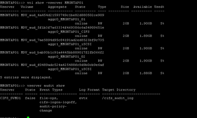

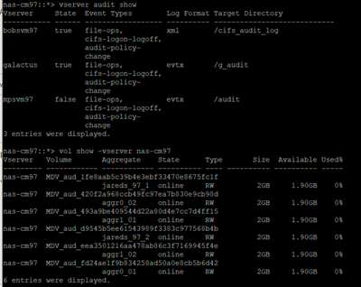

some output that would be helpful for your support case...
if you have cifs auditing setup, this info would have some config
