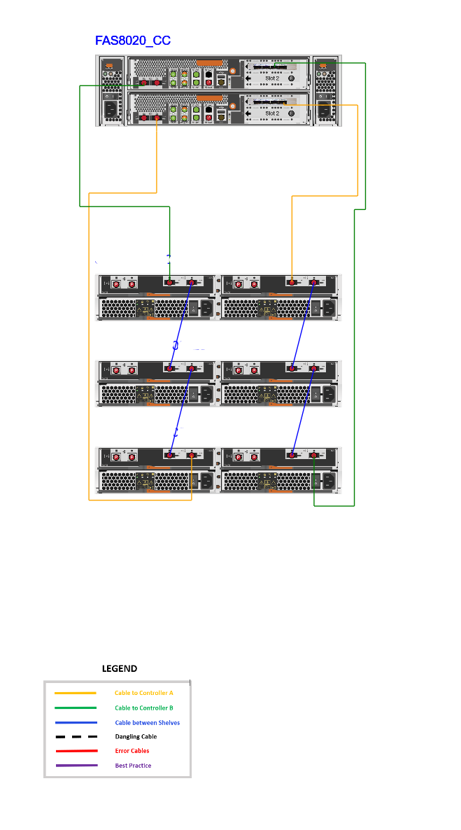

Hello
As it illustrate below this is FAS 8020 attached to 3 disk shelves DS2246 connected by sas cable .
i need to add new disk shelf DS4246
I do not know what the correct way to add the new disk shelf. Do I add it in a new stack or add it with the rest of the disk shelves in the same loop?  What is the difference between the two methods in terms of benefit ?
Whatever the correct way,  can anyone help me by clarifying in the drawing how the  cables will be connected when adding the new disk shelf?

Looking at your drawing, I would do something like this...
1. Disconnect green cable.
2. Connect cable from Shelf 3 IOM-B CIRCLE to (new) shelf 4 IOM-B SQUARE.
3.  Re-connect the green cable to SHELF4 IOM-B CIRCLE
Wait about 5 minutes and repeat the same with Orange cable.
1. Disconnect orange cable.
2. Connect cable from Shelf 3 IOM-A CIRCLE to (new) shelf 4 IOM-A SQUARE.
3.  Re-connect the orange cable to SHELF4 IOM-A CIRCLE
If you have ACP,  at this point cable the ACP cabling as it is in the cabling doc.
Wait 5 minutes and check to make sure that ONTAP sees the disks,  they should be unassigned because you disabled auto assign in the first steps.
Verify multi-pathing inside ontap and re-run Config Advisor.
If all is good,  at this point feel free to own and configure the disks or add them to existing aggrs.
Last steps:   re-enable disk auto assign and re-run Config Advisor.

S_Ahmed
7,002 Views
Thanks @SpindleNinja for your efforts
Could you help me to understand these points:
1- what is differance between connecting disk shelf in new stack and connecting in same stack (loop)?
2- Can you illustrate how to connect disk shelf in new stack?
There's diagrams in the above linked cabling doc.   I can't find a drawing of a FAS8020 specifically.    But if you look at the install guide for the 8040 and 8060  you can see the controllers with two shelves using the onboard ports.
https://library.netapp.com/ecm/ecm_download_file/ECMP1199907
This is different then your 8020 because, like i said before,   you can only have a single stack unless you have SAS expantion cards.
