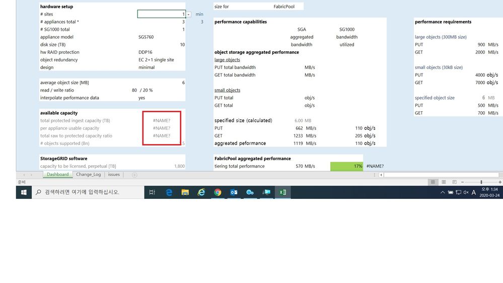

We are going to try to calculate the capacity through the storageGrid sizer.
However, the capacity below is not displayed properly.
can I know problem?
Thanks all..

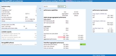

A few things to try...
  1. Change the drop-down for "HW Raid Protection"  in the "HW Setup" portion of the Sizer from "DDP16" to "DDP"
  2. When sizing for FabricPool, ensure that the value for "Average Object Size [MB]" is set to 4
  3. For the "Read / Write Ratio" section, should reflect 80 / 20, but remove the "%", only include the numeric value
Attached is a screenshot of a similar sizing that shows all outputs being populated correctly.

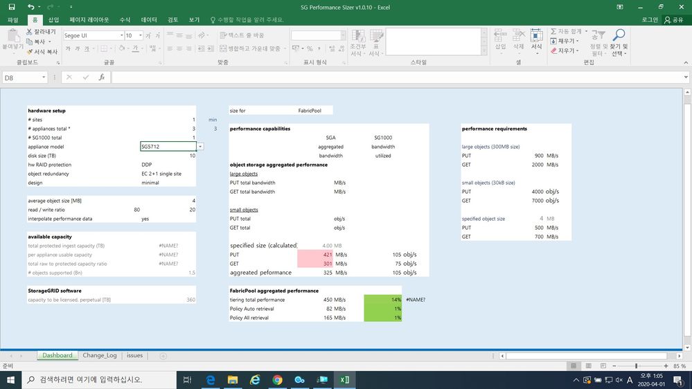

Run the  Excel sizer and first select a another model..Immediately an error(#NAME?) occurs.
Could it be Excel's option or version problem?
Attached is a screenshot.
Thanks.
