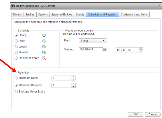

I  just read your article again and you indeed use the VSC.
In that case I would double check your VSC backup jobs at it looks they are poorly configured.
The VSC has it's own notion of snapshot retention and should roll those on its own.
I don't know which VSC version you run, but it should work similar to mine (VSC6.1). See screenshot from a backup job:
regards, Niels

Hello Niels,
Thanks for chiming in. Yes, I'm using VSC and I have set the retention (in days) with accordance to our RPO. I could reduce this but as I wrote before, most of the time, when VSC creates a snapshot for my (OS) datastores it triggers a snapshot for APP01 datastore also. Therefore I would have to reduce OS datastores' retention settings as well. Which would in turn affect their RPOs. Naturally, I'd rather avoid that. Having the snapshot count monitored and kept just below the limit seems the least costly way to go...
Regards,
