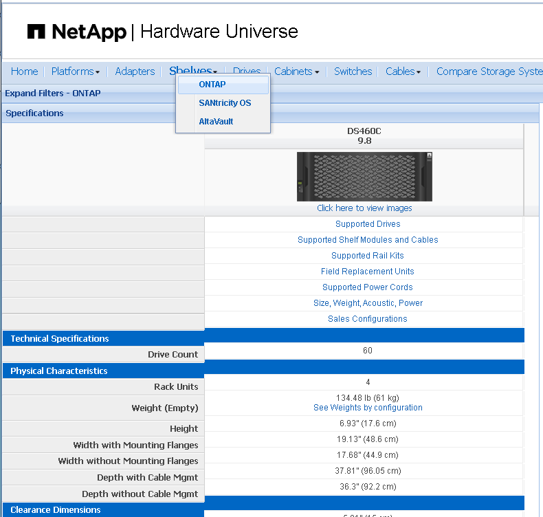

Hello,
As check with HU, DS460C site require as below:
- is DS460C have cable arm for "Depth with Cable Mgmt"? If yes, how can I found the pitcure or infomration abot cable arm?
- if no, why it have another requirement in "Depth without Cable Mgmt"?
Depth with Cable Mgmt 37.81'' (96.05 cm)
Depth without Cable Mgmt 36.3'' (92.2 cm)
Best regards,
Chung

There is no cable arm. The difference is about 1.5 inches which is the length the cables stick out the back of the SAS/Power ports. It is very deep. In a standard depth cabinet, the power/SAS cables will be up against the door (squished). In a deep cabinet, there are a couple of inches or so between the cables bends and the door.
