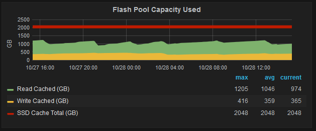

Is there any way to allow Flash pool to use all of its capacity, at least for read caching?
This system is running ontap 8.3.1
Image from graphite+netapp-harvest

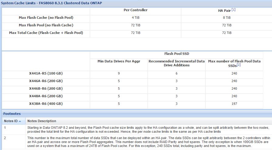

The maximum size of the Flash Pool cache per system is a function of the controller model and the Data ONTAP release in use. In addition, when both Flash Pool and Flash Cache are used on the same system, the maximum cache size for each caching solution applies, as does the total maximum cache value for the combined use. For details refer section 3.3 Maximum Cache Capacities of the TR-4070. You can refer Hardware Universe to get the specifications for the controller model that you are currently using.
For eg: I have pasted a copy of the limits for the FAS 8060 controller running cDOT 8.3.1.
So even if your system has more cache, only the allowed maximum will be used. Hope this helps.

The question isn't about the limits of flahpool. It's about how to maximize the usage of the currently installed (and within the limit) flashpool
