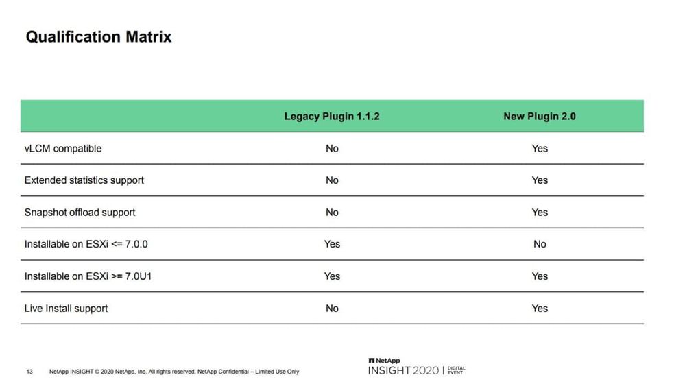

About vLCM support:
The current version of the NFS plug-in for VAAI is only compatible with VMware ESXi 7.0, but not with 7.0.1. The next version 2.0, which will be compatible with 7.0.1, was scheduled for release this month and would contain this feature. I would recommend you to subscribe to the below RFE in order to be notified for updates:

navion
35,425 Views
It should work with 7.0.1, but you can't install the plugin with vLCM.
In addition, only vSphere 7.0 U2 provides the ability to use native NFS snapshots:
https://blogs.vmware.com/virtualblocks/2021/03/09/vsphere-7-u2-core-storage

35,340 Views
Thanks for the notice! 🙂
The slide above, with the support matrix... looks like it came from a presentation at Insight. What was the topic of the presentation? Hoping to find something to watch/read to learn a little more.
navion
35,312 Views
DEM-1265-2, but it lacks any technical details.
