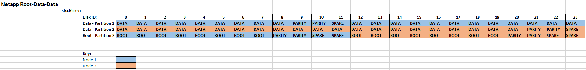

First test scenario - Full system initialization with 1 disk shelf (ID: 0)
The system splits the ownership of the drives and partitions evenly amongst the 2 nodes in the HA pair.
Between disks 0 - 11, partitions 1 and 3 are assigned to node 1 and partition 2 is assigned to node 2
Between disks 12 - 23, partitions 2 and 3 are assigned to node 2 and partition 1 is assigned to node 1.
Creating a new aggregate on Node 1 with Raid Group size 23 will give me:
  • RG 0 - 21 x Data and 2 x Parity
  • 1 x data spare
One root partition is roughly 55GB on a 3.8TB SSD
Benefits of this setup:
  • root and data aggregates spread their load amongst both nodes
Cons:
  • Single disk failure affects both node data aggregates.
It could possibly be better to re-assign partition ownership so that disk ID 0 - 11 are owned by node 1 and 12 - 23 are owned by node 2 ?
netapp-adp2-single-shelf

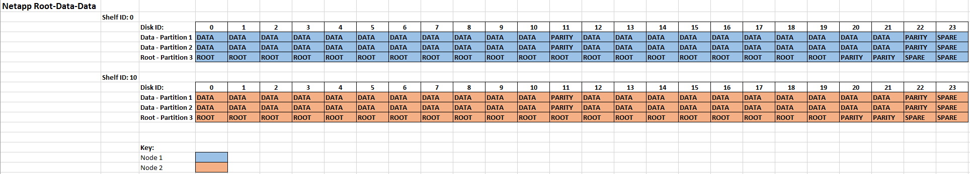

Second test scenario - Full system initialization with 2 disk shelves (ID: 0 and ID:10) - Example 1
The system splits the ownership of the drives between both shelves with the following assignments:
Node 1 owns all disks and partitions (0 - 23) in shelf 1
Node 2 owns all disks and partitions (0 - 23) in shelf 2
  • RG 1 - 21 x Data and 2 x Parity
  • 2 x data spares
 One root partition is roughly 22GB on a 3.8TB SSD
The maximum amount of partitioned disks you can have in a system is 48, so with the 2 shelves, we are at maximum capacity for partitioned disks. For the next shelf, we will need to utilize the full disk size in new aggregates.
Benefits of this setup I see:
  • in the case of 1 disk failure or a shelf failure, only 1 node/aggregate would be affected.
Cons of this setup:
  • A single node root and data aggregate workload is pinned to 1 shelf
It's possible to reassign disks so that 1 partition is owned by the partner node which will allow you to split the aggregate workload between shelves, however in the case of a disk or shelf failure both aggregates would be affected.
netapp-adp2-2-shelves

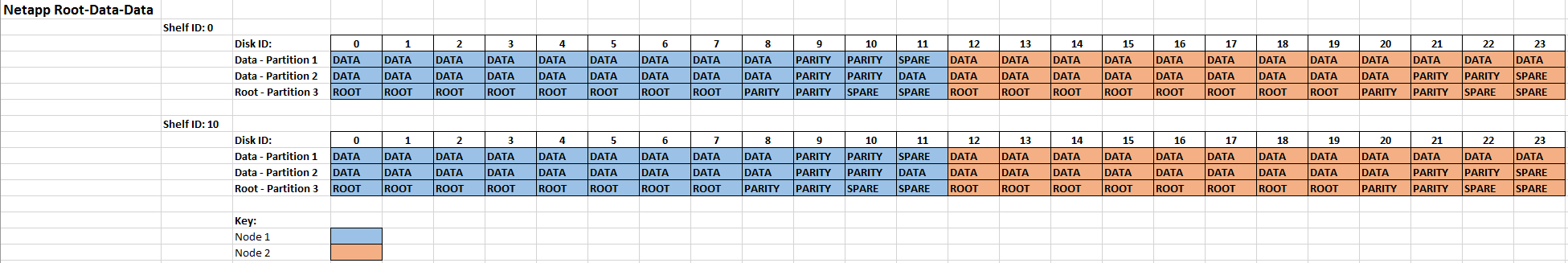

Third test scenario - Full system initialization with 2 disk shelves (ID: 0 and ID:10) - Example 2
In this example, I re-initialized the system with only 1 disk shelf connected.
Disk auto assignment was as follows:
  • between shelf 1 disks 0 - 11, partition 1 and 3 are assigned to Node 1 and partition 2 is assigned to Node 2
  • between shelf 1 disks 12 - 23, partition 2 and 3 are assigned to Node 2 and partition 1 is assigned to Node 1
I then completed the cluster setup wizard and connected the 2nd disk shelf.
The system split the disk ownership up for shelf 2 in the following way:
  • Disks 0 - 11 owned by node 1
  • Disks 12 - 23 owned by node 2
Next, I proceeded to add disks 0 - 11 to the node 1 root aggregate and disks 12 - 23 to the node 2 root aggregate. This partitioned the disks and assigned ownership of the partitions the same as shelf 1.
Because the system was initialized with only 1 shelf connected, it created the root partition size as 55GB as opposed to 22GB in my second test scenario above. What this means is that a 55GB root partition is used across the whole 2 shelves as opposed to 22GB. How much space do you actually save when using 3.8TB SSD's:
55GB x 42 (Data disks) =  2,310GB
22GB x 42 (Data disks) = 924GB
Difference = 1, 386GB or 40%
  • Load distribution amongst shelf 1 and 2
Cons:
  • Larger root partition
  • single disk or shelf failure affects both aggregates
netapp-adp2-2-shelves-2
Fourth test scenario - Full system initialization with 2 disk shelves (ID: 0 and ID:10) - Example 3
Following on from my thrid test scenario, I re-assign the partitions so that partitions on disk id: 0 - 11 are owned by node 1 and 12 - 23 are owned by node 2
  • 1 disk failure only affects 1 node root and data aggregate
  • equal load distribution amongst the shelves.
Cons:
  • 1 shelf failure will affect both nodes
 netapp-adp2-2-shelves-3

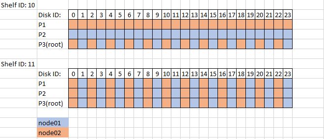

It is an A200 w/ 2 shelves (internal + 1 224) and ADP, but judging by the root partition size (55GB), it looks like it was configured first with a single shelf.  Playing around on synergy, a 2 shelf config should have the 22GB root partition (like you got in scenario 2).  This would be my preference.  I kicked off a 4a and it did partition the 2nd shelf drives, but I'm thinking that because I did not remove all the existing partitions first, they ended up being 55GB.  I'm going to follow this procedure and re-initialize
https://library.netapp.com/ecmdocs/ECMP1636022/html/GUID-CFB9643B-36DB-4F31-95D4-29EDE648807D.html
Here is how it assigned the partitions, which I thought was a little odd.
davidrnexon
26,698 Views
yes that's correct, it will partition the new shelf but keep the root partition size the same, which in your case is 55GB.
If you want to get the partition size down, you'll need to remove everything - volumes, aggregates, partitions and disk ownership.
With the 2 shelves plugged in you can then re-initialize node 1 (keep node 2 in the boot loader until node 1 is finished), it will take half the disks, own them and partition them with the smaller root size. Then you can do the same with node 2.

That worked well, root slice is 22GB, config of the 2 shelves matches expected from Synergy.  However, I just added a 3rd shelf.  My understanding was ADP will only partition 48 disks, but when I created a new aggregate with the new shelf, it partitioned those as well.  I did not expect that.

Following up on my issue from before, per support, the 3rd shelf was partitioned because when I created the second aggregate I didn't explicitly specify the disks to use.  There were two partitioned spares per controller still available, as well as 12 'whole' disks.  In the GUI, I chose the disk type to be the latter, but for whatever reason, it chose to use the partitioned spares first, and in order to make the raid group the same disk type, it had to partition the whole disks.  Weird I thought.
Easy fix though, blew away the aggregate, blew away the partitions, and created new aggrs via command line explicitly picking the 11 disks I wanted.
