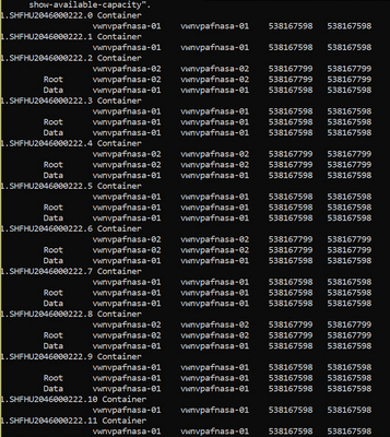

You are lacking in your detail. For any help to be produced, you need to supply more details about your config.
Do you have a local NetApp Partner or NetApp SE to work with?
You probably need to end up removing ownership of all the "data" partitions and assigning them to one node. Then decide if you want to split the remaining drives between nodes.
For example, from the cli:
storage disk option modify -node * -autoassign off
disk show -fields data-owner
(for each drive listed for node-02)
  • disk removeowner -data true -disk <disk_id>
  • disk assign -data true -disk <disk_id> -owner <node_01>
Then decide if you want to split the remaining 30 drives:
  • disk assign -count 15 -owner <node_01>
  • disk assign -count 15 -owner <node_02>
Then create your aggregates
  • aggr auto-provision -nodes node-01,node-02 -verbose true
  • This will tell you exactly what it is trying to do. if you do not like it, you can always use the CLI to create the aggrs
