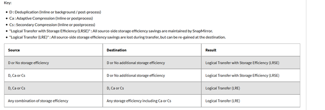

Dear Community,
I have a Question on the following Szenario:
Cluster A , Volume with Dedup enabled -> Snapmirror XDP to Cluster B AFF System all Efficieny function are enabled.
after I break the Mirror and went online on Cluster B I have Dedup Savings.
But the Table says it must be LSR and all Efficieny functions will be regenerated on the destination, so how can I use compaction and compression on that Volume?

Fabian1993
4,678 Views
Nothing worked,  only If i delete the old Snaps, the the commands with scan-blocks and manuell starts will work and the  Efficiency functions during their Jobs, but with the old Snapshots it doesn't work...
