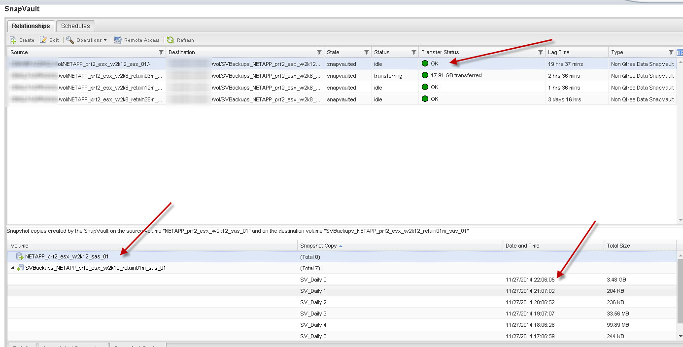

Below is the snapvault job I have created on the destination filer, it has performed the initial baseline transfer ok but I am having trouble it creating further snapshots from this, the last snapshot it created was the 27th of last month and I dont fully understand why it has suddenly stopped.

Ok on the source side we dont use qtrees at all. The snapmirrors are all volume snapmirrors and where we are using Snapvault they are all "non-qtree snapvault relationships". On the destination side though there needs to be a qtree so there is a qtree for the snapvault volume destination so in the case of the example I gave earlier it is set out like this:
Source - CENWBFASDR02:/vol/NETAPP_prf2_esx_w2k12_sas_01/-
Destination - CENWBFASDR02:/vol/SVBackups_NETAPP_prf2_esx_w2k12_retain01m_sas_01/q_NETAPP_prf2_esx_w2k12_retain01m_sas_01 (q signifies its a qtree)
