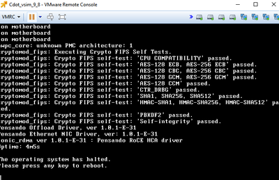

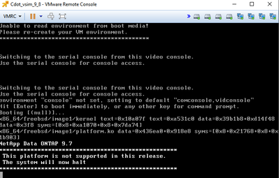

I deployed a 9.7 vsim. Upgraded it to 9.8 and now vsim wont boot.
seeing these errors

If you look at this image, it says "This platform is not supported", have you changed the following platform settings from VLOADER?
SYS_MODEL=SIMBOX

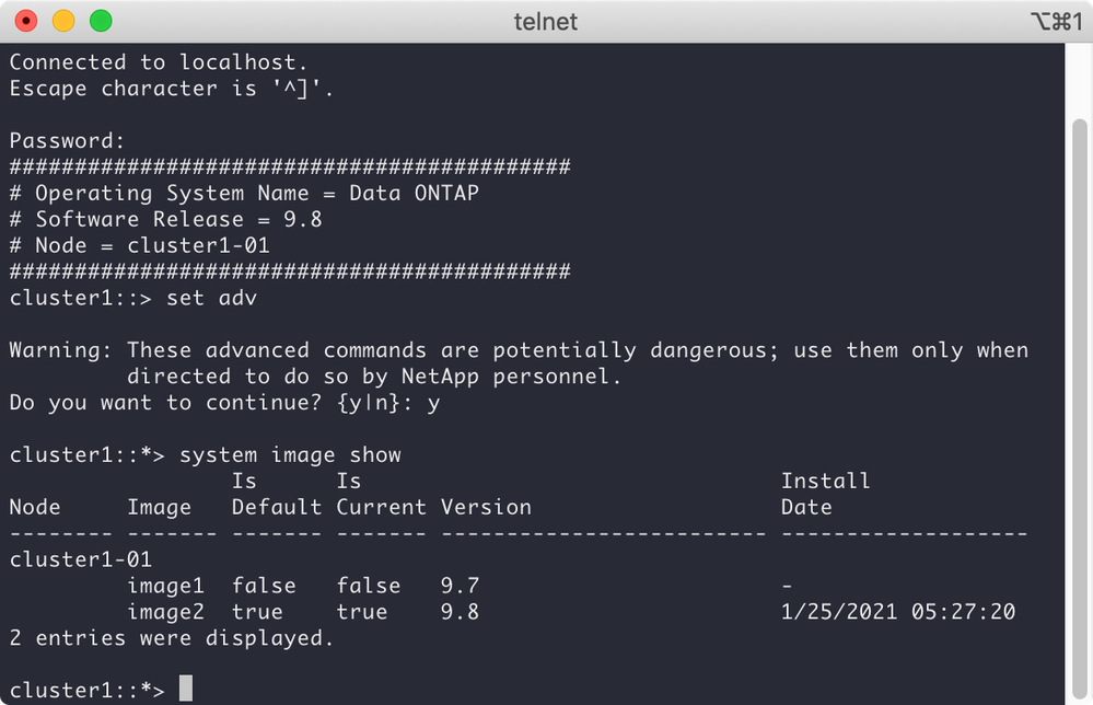

Yesterday I upgraded from ONTAP 9.7 simulator to 9.8 and it completed successfully. But with ONTAP 9.7, it worked with the default memory of 5GB, but after 9.8, I had to set it to 8GB to start.
SYS_MODEL=SIMBOX

Thanks for your suggestions.
I was able to bypass that but it somehow failed again later
