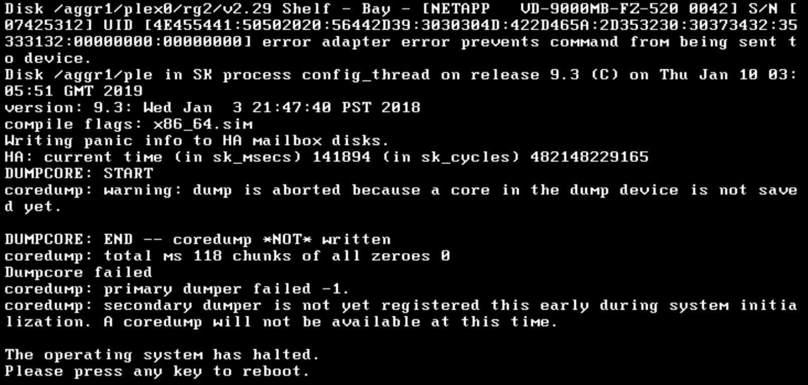

Hi,
I have a vSIM 9.3 setup and running on my test lab, recent check I found there is some issue with it as the screenshot as attached. This is actually the 2nd time it had happened. Not sure if this could be fixed instead of rebuilding them.
So its actually running on VMware ESXi 6.5.
1 ACCEPTED SOLUTION
SeanHatfield
10,810 Views
From what I see in the screenshot, you are using 9GB simulated disks.  If the SIM has been in use for a while, you may have filled the virtual disk that the simulated disks are stored on.
You can check this by stopping it at the boot menu, entering the systemshell, and running df to see the available space on the /sim filesystem

If your /sim file system is filling up, the default size of the IDE1:1 disk is too small for your simulated disk layout.  You can either provision fewer or smaller simulated disks, or you can replace IDE1:1 with a larger disk before the very first power on of a new simulator.

Can you please increase the virtual machine RAM to 5.1GB if running single node otherwise 5.1GB multiply number of nodes.
ndminus
10,976 Views
there RAM is already assigned at 5.1GB, I had increased it to 8GB but still failed to boot up.

ndminus
10,773 Views
Yes, Im guessing the disk is full too based on the error messages i managed to catch earlier during boot.
I have already increase the disk previously during my initial deployment. Correct me if I'm wrong, vsim only supports up to maximum for 550GB right?
SeanHatfield
10,756 Views
The raw sim disk file size could be as much as 9.9GB, depending on the disk type, for up to 56 disks.  I round up to 600GB just to leave some buffer.  There are a few other odds and ends on the /sim partition, along with its file system overhead.
