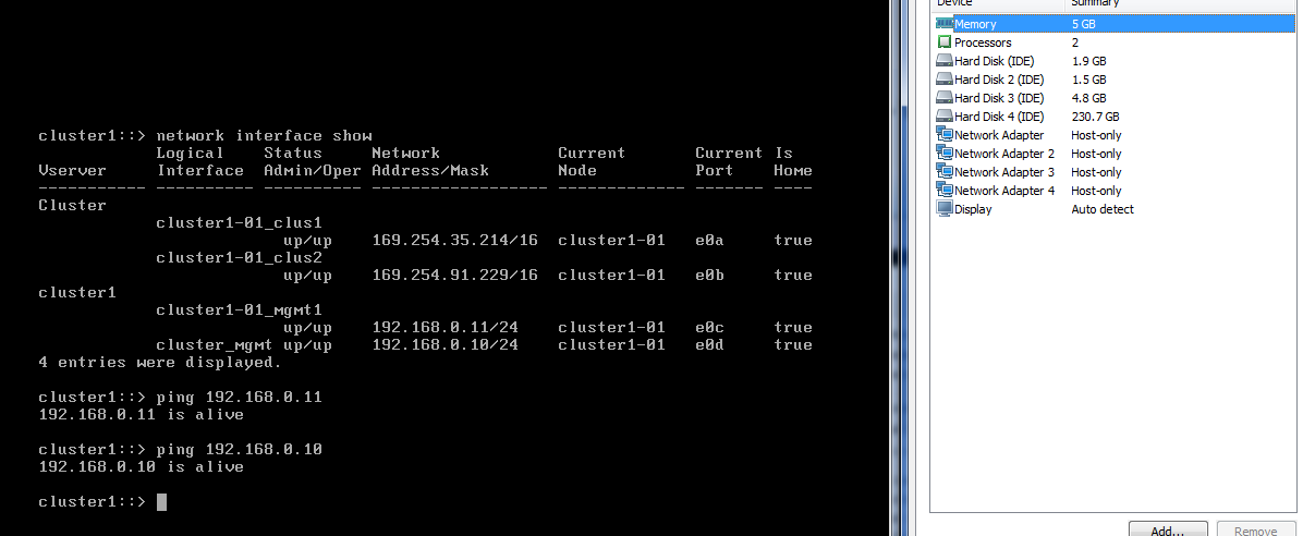

I have installed Netapp Simulator 8.3.2 in VM workstation 10 using deffault settings.
I have assigned 192.168.0.10 for cluster mgmt and 192.168.0.11 for node management.

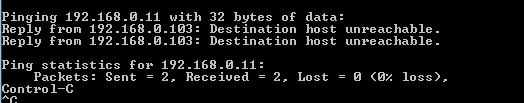

I am not able to ping these IPs from the host. Similarly from the netapp simulator I am not able to ping the host.
Can some please help on what i need to do to fix this?

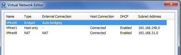

Note - I didn't do any changes in the Virtual Network Editor before or after installing. I used the default settings.

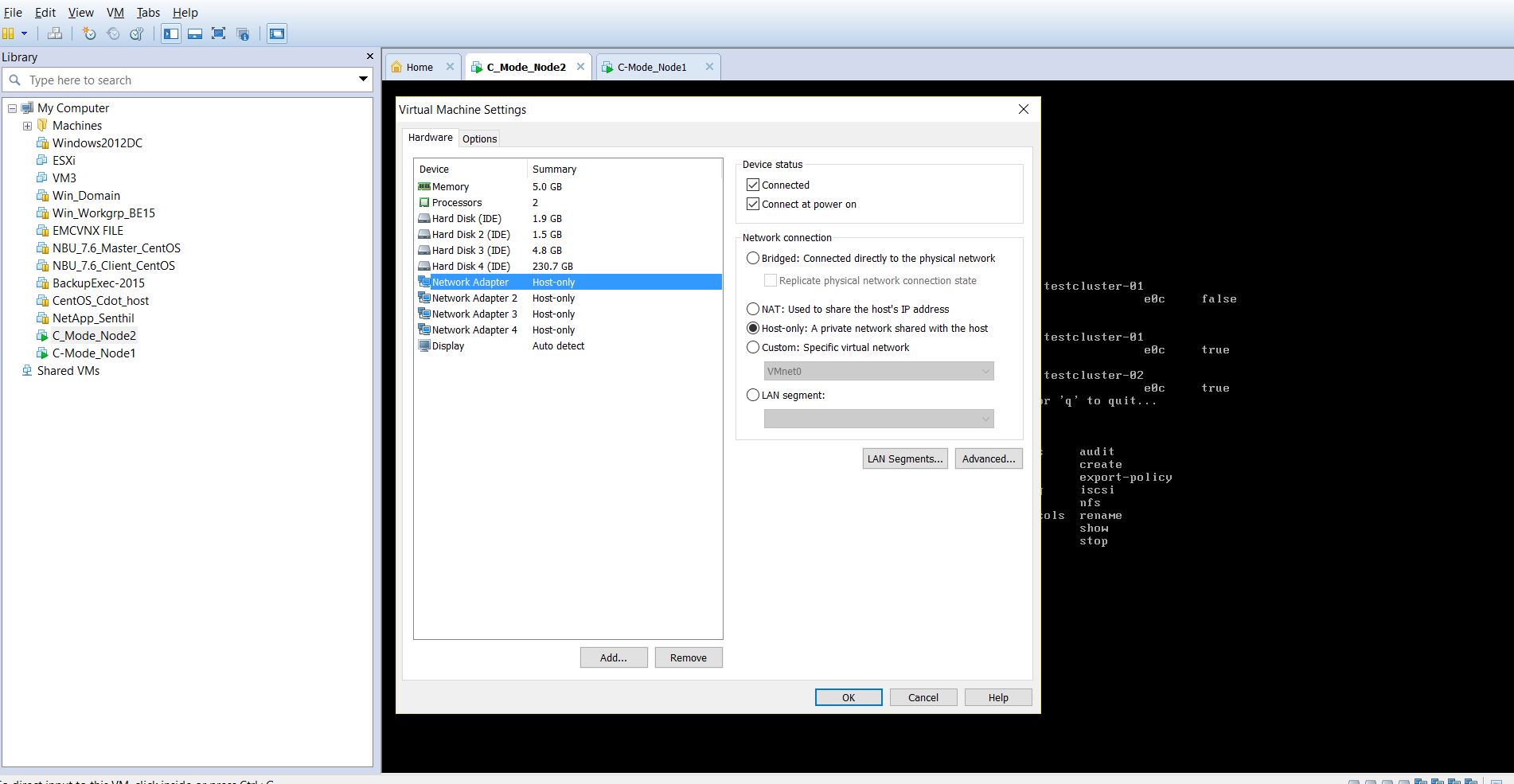

Can choose the interface type as host-only option in the VM settings and try.........

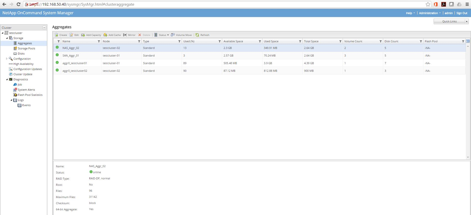

Can use the Cluster Management IP address directly in browser to access the System Manager.........

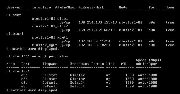

Thanks for the detailed info. Unfortunately still it's not working. I have changed all the interfaces to host only and reinstalled the node

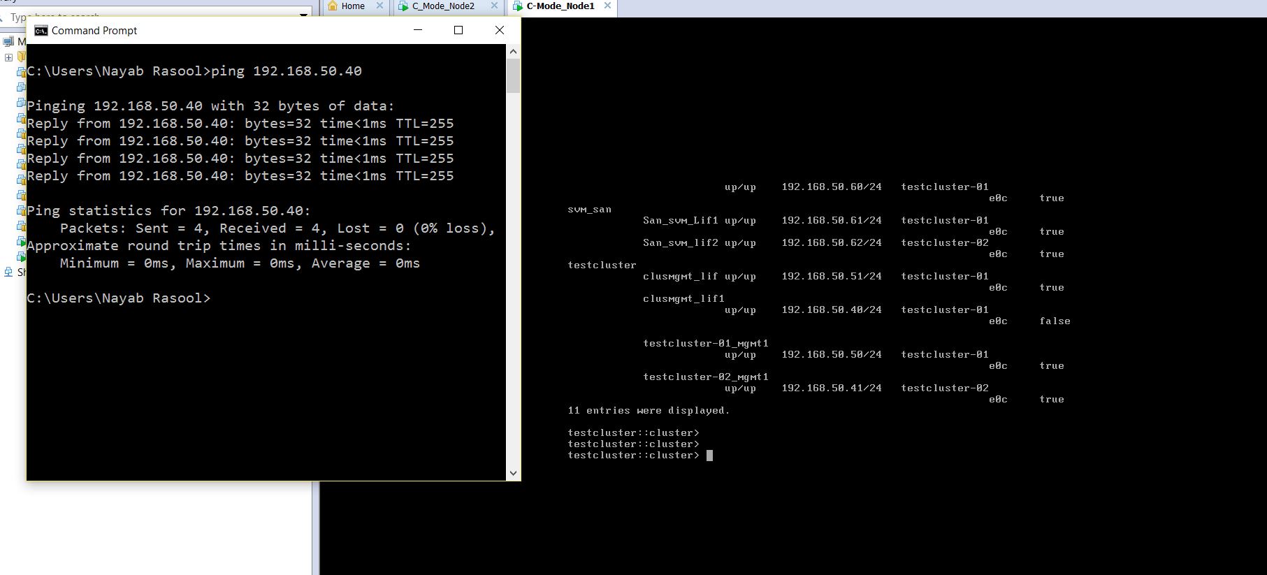

Actually i have tried in the Lab and letting you know....
My Machine Ip is also same subnet as my Simulator and i have changed the host interface to host-only and i had it working from my host
Just give a try and let me know....

wh_slayer
16,727 Views
A host-only network will only allow communication between the VMWare host and the VMs.  There is no access to the VMs outside of the host.
In the screenshot of the VM Network Editor, your host-only network is 192.168.248.0/24.  That is the subnet you must pick from for your addresses in the simulator.  The VMNet1 device on the host system is probably using 192.168.248.1, so pick something other than that for your simulator.
