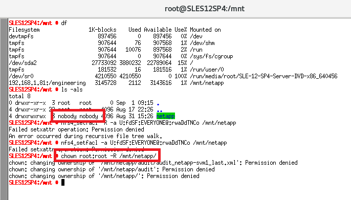

1. I create a aggrgate and a volume which include CIFS and NFS protocols.
2. I try to use suse to mount it by using  mount.nfs4....it mount well.
After mount well...I  try to set nfs ACL by using nfs4_setfacl....
it show error message, whether parameter that I set mistake or something I forgot ??
Thanks!!

Looks like you're doing a recursive v4 ACL.
Did you try without -R?
What is the security style of the volume?

      as  screenshot, I try to remove -R to set ACL...it show permission...
and I try to chown command...still show permission deny
sorry , I am not linux expert...
whether I should set user could for NetAPP's NFS volume ? or need other actions? to let could run nfs4 set ACL command well ??
thanks

"nobody:nobody" means that your NFSv4 ID domain is likely mismatched.
What does /var/log/messages on your client show?
You're likely seeing messages like this:
2020-09-01T11:26:17.072485-04:00 sles15 nfsidmap[5338]: nss_getpwnam: name 'nobody' does not map into domain 'DOMAIN.COM'
NFSv4.x requires the following:
- domain set in idmapd.conf
- same domain set in the NFS server option v4-id-domain in ONTAP
- users and groups that match on both client and ONTAP SVM

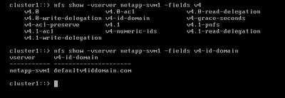

I check v4-id-domain...Yes...I need modify
I have add LDAP setting on SVM_setting from WebConsole...this v4-id-domain could been modify from web console ??

it's definitely in the GUI in 9.8:
Probably is in 9.7 as well (in the NFS config section).
Older System Manager likely has this as well.
