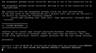

      I create a single node cluster for CIFS testing...I had create a aggrgate &volume for CIFS share .
after all setting..I  could connect it from a Win10 Workstation..
but one day later...My Cluster show Mroot messagt like below
I do not need backup anything on my lab
How could I disable the backup task ??

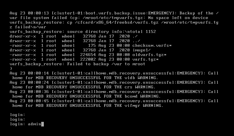

Hi
   If I could not disable backup task...
Could I extend Mroot ? Because it always show /Mroot "no space left on device".
I had let the root aggrgate from simulator's original size to extend 8 GB size (add 6-8 virtual HD size)
but the extend action seem did not also extend /Mroot.

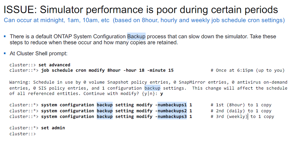

   when I  search from google...I get a PPT file..it show I could modify system backup setting..
Although it only let me set the minimal number is 1 ...but could I set disable ?
Wencheng

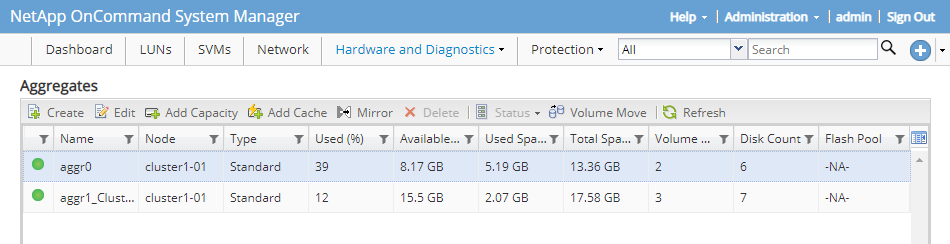

I revert snapshot to clear setting..
I see the vol0 in aggr0-clustername-node01...
even I extend aggr0...the vol0 still keep original size...and I seem could not modify size....
Because I will test audit log later...it seem also use the aggr0...
correct ?

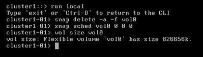

AlainTansi
11,693 Views
Hi ,
Mroot is in the root volume vol0, meaning, resizing vol0 i think should resolve the issue. You can also disable snapshots on the root and set the schedule to 0 0 0 so that no snapshots be taken that will consume vol space.
Delete root vol snapshot and schedule
Cluster1::> run local
Cluster1-01> snap delete -a -f vol0
Cluster1-01> snap sched vol0 0 0 0
Add capacity to vol
Cluster1::> vol modify -vserver <vserver_name> -volume <vol_name> -size +1g   #to increase vol size by 1GB

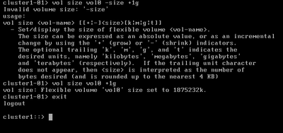

HI Thanks your information about vol0
when I occur this problem in my lab...
I did your procedure
then extend vol size to add 1 G (this command's parameter seem different on 9.7)
after reboot...it occur message like below...
whether I need extend vol0's size before I meet this problem or not ??
Sorry, I am not NetAPP expert , I just want to build a NetAPP NASlab to testing .

recently, I install old OnTAP 9.0 version
then I do same procedure to create a volume which enable CIFS and NFS..
it running about 3 days...it does not occur backup issue or Mroot space did not enough.
Whether the OnTAP default space are more space to let backup task runing ?
