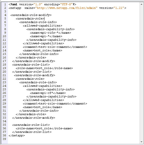

I did use already ZEDI, no way there is the same result, look in the atached Screenshots first is the XML-Request:
and the Second are the results of it:
the main reason why i'm tryin to use it is that i want change some roles on our systems we have ~30 Filers and to do this manually everytime is not the perfect solution....

Actually, your ZEDI output shows exactly what I was talking about.  It appears that the first <useradmin-role-modify> call which had two capabilities in it only set one - "api-cifs-*" per the "list" API.
That is either a bug in intended behavior or it is intended because of the two capabilities you listed - if you combine the two capabilities in the first call "api-*" and "api-cifs-*" the logical "least" capability intersection of those two is just "api-cifs-*".  More experimentation would be needed, or documentation, to ensure that's what it really does.  Of course given the code in the original post, I'm leaning toward "bug".
For the second call, remember that in the CLI you have to fully specify all permissions because modify acts as a replace.  So the second call, with just a single capability listed, modifies the role to have only those capabilities.  If you want to add a capability, you also need to specify all the existing capabilities, as I recall from the CLI.  If I remember correctly, and since the CLI just calls the underlying API, the 2nd output is what I would expect.
