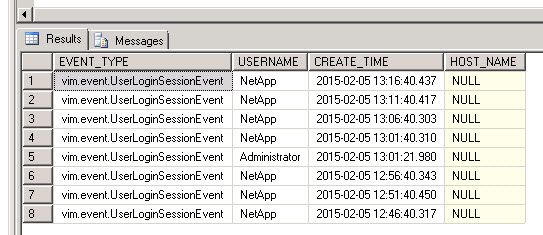

Over a sql query, we found that in 5 minute intervals login and logout sessions are created in both tables.

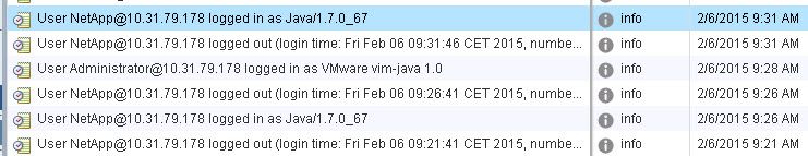

In the vSphere Web Client it could be analyzed in more detail with the logging events.

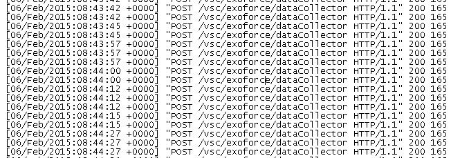

After searching the internet, we have the log files of the vsc plugin in windows closer viewed -> " C:\Program Files\NetApp\Virtual Storage Console\ log".
The main reason for the filling of the tables in the vCenter database is the log file named "requests-2015_xx_xx.log".
The following entries in the log file is filling the tables in the database until it comes to a standstill.
