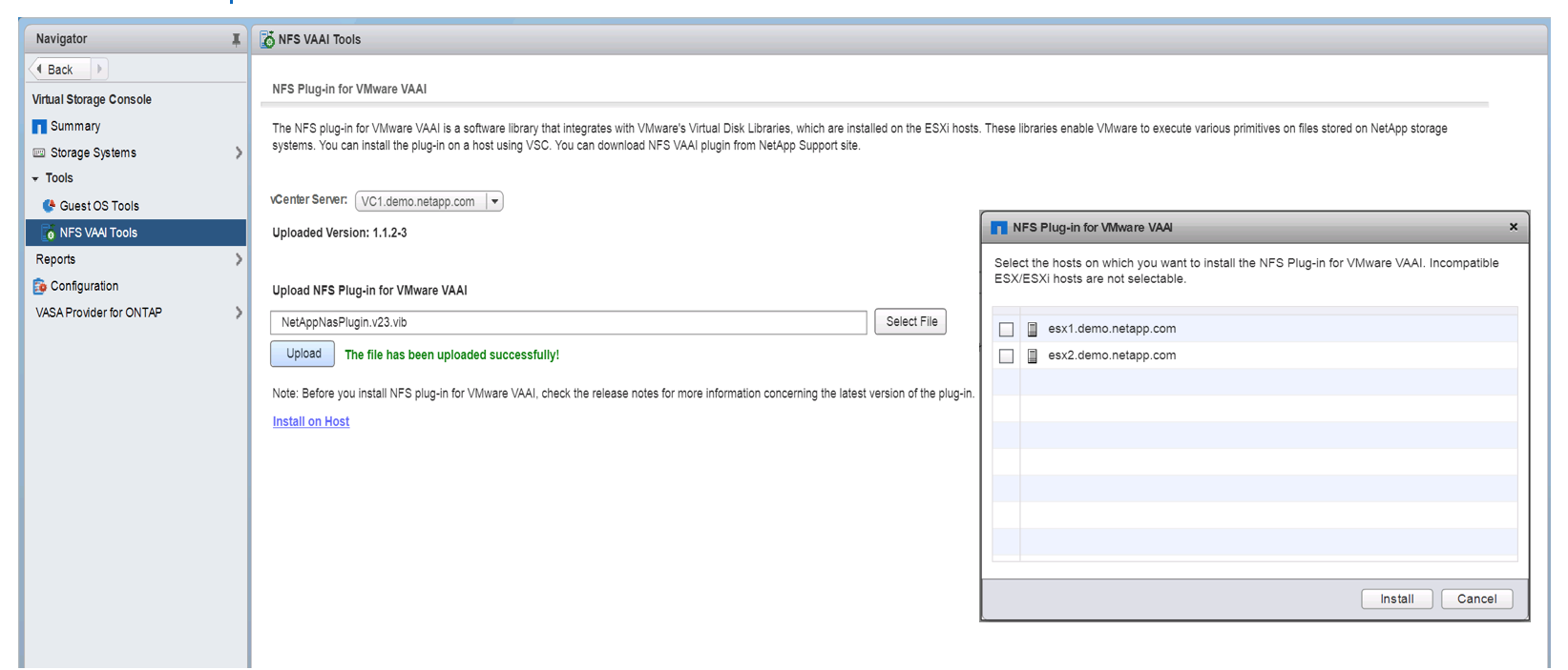

Under NFS VAAI Tools Link
morrisetteg
18,759 Views
Wow, can't believe I missed that.  TYVM

Now to figure out why it thinks hosts are incompatible from this screen but I can install by right clicking the host and selecting NetApp VSC/Install NFS Plug-in...
