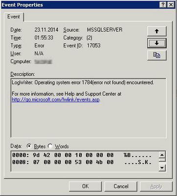

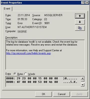

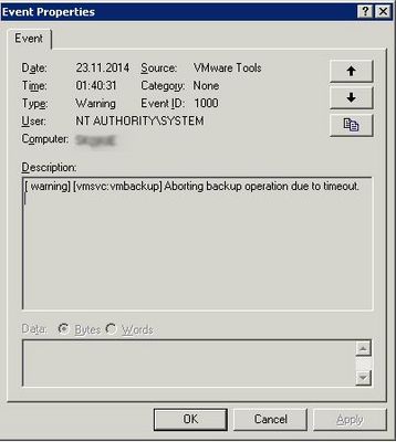

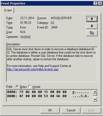

Subsequent log analysis through Event Viewer showed me that the first errors are always logged by VMware Tools - precisely 15 minutes after VSC backup job is initiated on that VM (during the night),
Which is then followed by SQL service stopping:
