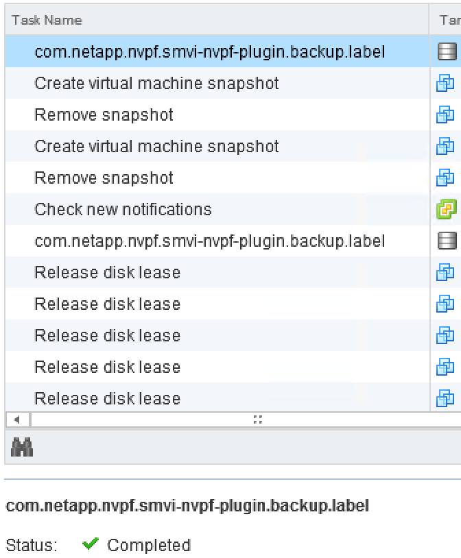

I am using 6.2.1P1 on VCSA 6.5 and its working but I have noticed a few issues.  First the descriptions for any of the tasks that tht VSC does in vCenter are not showing correctly is the task list.  Also having the plugin installed breaks option 2 from certificate manager.  The work around is to run certifficate manager to replace the SSL certs before you install the VSC plugin.

I have also seen a problem with task descriptions:
- vcsa 6.5a
- register vsc 6.2.1 succesfully to it
- added storage controllers to vsc (I have another problem with it, see https://community.netapp.com/t5/VMware-Solutions-Discussions/VSC-6-2-1-P1-Incomplete-Netapp-Storage-System-detection/m-p/128535#U128535 )
When I do a host and storage discovery and then reboot vsc and then reboot vcsa, all vcenter task descriptions are broken and are shown with ".label" descriptions. Not only those those tasks which have something to do with VSC. Every task f.e. rebooting a VM and the descriptions in host profiles manager. I have then to revert to a vsca-snapshot before vsc registration.
JeffRusso
19,804 Views
At one point I believe I was seeing the broken label descriptions for everyting but I removed VSC and rebooted the VSCA and the server the VSC was installed on.  Next I reinstalled VSC 6.2.1P1 and replaced the jre in the VSC install directory with Java 8 Update 77 (this fixed the issue when viewing the logs of the VSC backups from the email link).  Since then (fingers crossed) the task label issue has only occured with the NetApp tasks.

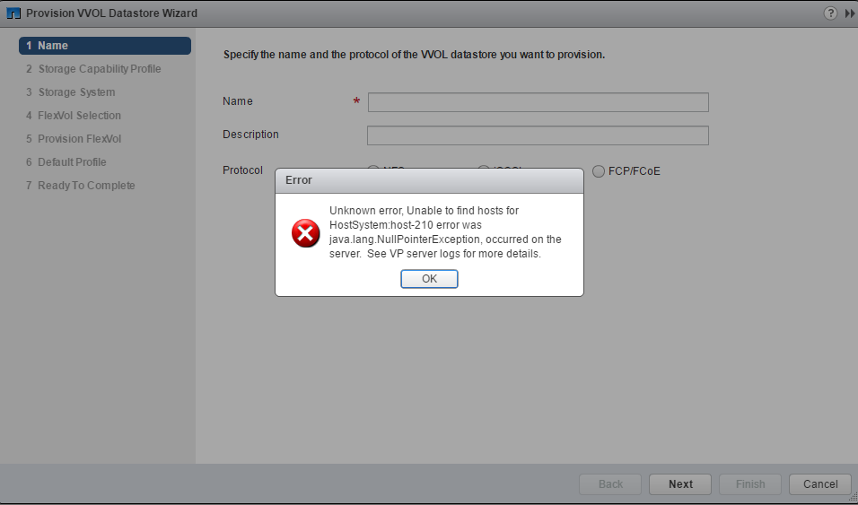

Installed the new VSC listed in this thread. Also installed the latest VASA appliance. I'm trying to get a handle on Vvols for the first time. Is anyone having problems creating Vvols with 6.5 VCSA?
Im getting some kind of java error. See pic
vanessa
16,608 Views
I was having the same issue. I opened a case with netapp, the technician told me there was open bug, and gave me bug ID 1069251

I updated today the VCSA from 6.5 to 6.5 Update 1 and I have now the "task description label" Problem. 😞
Installed VSC Version: 6.2.1P1
I found in the VMware forum the reason why the VSC caused the problem:
"The plugin version was 6.2.1P1D1, which was where the problem ended up being. 6.2.1P1D1 is the service version for the plugin and the Virtual center JAR only interprets service versions on plugins that contain numbers, it cannot interpret letters. When it tries to process the Netapp plugin it fails and never loads the rest of the files containing the appropriate lables."
https://communities.vmware.com/thread/511581?start=15&tstart=0
But unfortunately there is no solution except to disable the VSC plugin.
Is there already something new from NetApp?
mrc247
16,677 Views
I have changed back to the snapshot before the update and the problem persists, although it was not there until today, how can that be?

we had some issues with vcenter 6.5 and vsc 6.2.1P1D1.
All was fixed with new 6.2.1P1D2 🙂
https://mysupport.netapp.com/NOW/download/software/vsc_win/6.2.1P1D2
Best regards
