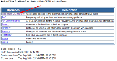

You can try using the VASA Provider's web interface.  Browse to https://your.vasa.provider:9083/ and login using the vpserver user (you set the password during appliance deployment).
Once there, click on the "Web Based CLI Interface Link":
Web Based CLI Link

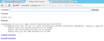

In the page that opens, type "cluster list" in the input box:
Cluster List
You should see something like this:
cluster list result

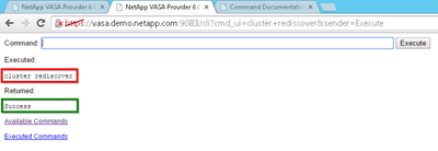

Assuming it's not correct, in the command text box put "cluster rediscover" then hit the execute button.  This may take a few minutes depending on the number and size of the clusters.
cluster rediscover
Afterward, do the "cluster list" again to check for accuracy.

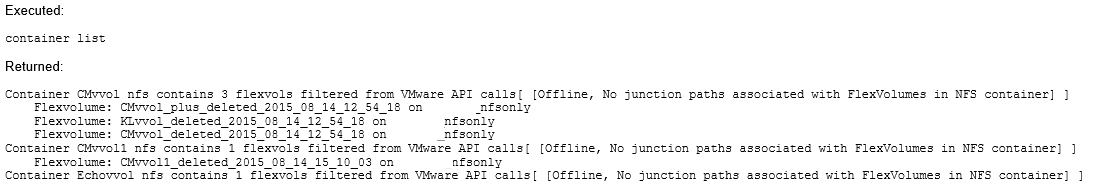

I figured I would try to include a graphic to help represent what I am seeing. The cluster list command shows me all of the vvols - deleted and online. The ones that show deleted are the ones either failed provisioning through the plugin or that I removed from the array manually...so it looks OK there. However I think the issue might be around the storage containers because if I list these out from the plugin's perspective, it shows the ones that are giving me the naming conflict as offline, but still in the list even though their backing storage is deleted on the array. The ones that show offline are the ones that the Web Client thinks still exist and throw a name conflict with when I try to provision a new datastore:
So if I try to reuse the name for any of the containers in the list that show as offline, that is where my issue appears to be. Since they don't exist on the array through and since we did a rediscover, how come they aren't cleaning themselves up? Or is there a manual way to clean these containers up either on the VMware side or on the NTAP side so they don't report like this?

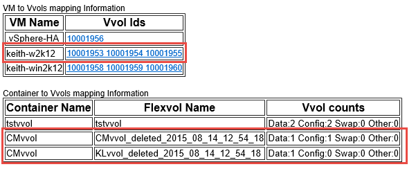

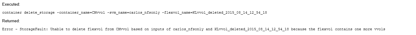

Thanks Andrew! We are getting there. I was able to delete the empty flexvols and containers from the list, however with one of them that went inaccessible and the VM was removed (and assumed the vvols were too) it looks that they weren't and the provider thinks that the VM that originally was create on this vvol datastore (CMvvol) is still there according to the outputs:
It seems to think that the VM that has been removed (keith-w2k12) still has vvols on the container and the VM is nowhere in vcenter inventory that I can see:

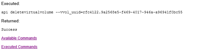

So what I found was that I could look at the inventory (snippet above) and I found the "api deletevirtualvolume -vvol_uuid" command to manually remove all of the dead vvols that the VP thought were still out there on the DOA container:
I repeated that process for the other 2 leftover vvols and then I was able to remove the 2 flexvols from the container and then delete the container itself (container delete -container_name=CMvvol).
Once I did all of this, I refreshed the VP from the Web Client and no longer see the duplicate name issue when trying to provision a new vvol datastore 🙂
