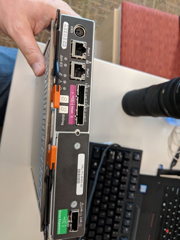

On the back it just has two ethernet and three sas ports.  So I am assuming it only supports sas.  Is that correct?

Mmm.... Are you able to post a picture?    but yeah,  probably just 2 sas to the hosts and 1 expansion port.

Yep.   just sas.
If you look at HWU, there are adaptor cards out there to add FC or iSCSI to it.
X-52710-00-R6 is the 2p 10Gb iSCSI card.     (not sure current availability though)
check out https://hwu.netapp.com for more details.
