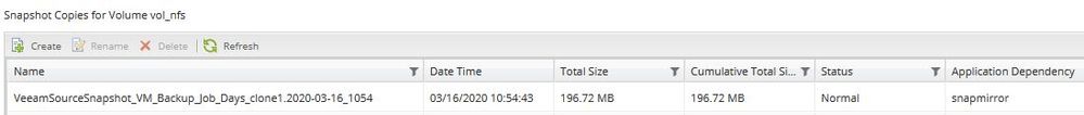

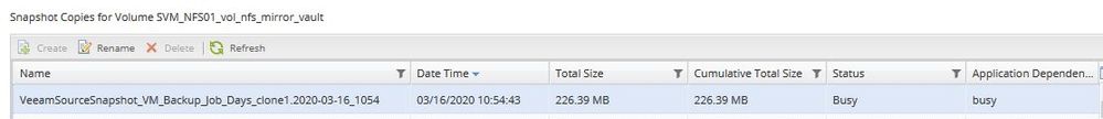

The veeam snapshot copy of netapp  status is busy  and application dependency is also busy
The backup in veeam start at 11:00,  the report of backup is warning :Failed to initiate snapshot transfer
The size of snapshot is still grow.
it is almost more than 3 hours.
How to solove this issue? thank you so much.
screenshot1:  primary storage
screenshot2: secondary storage

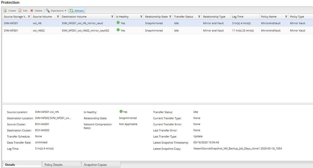

screenshot3:     protection

below is the more description:
1.the status of busy is not stop ,unless make  a manual sync or automatic sync backup
2. then the busy one will transfer  and finished quickly.
3. the new sync will again go to a busy status.
it's like a cycle...
I try to delete the snapshot ,but it is failed to delete. due to the snap in use.

rp722
6,317 Views
the Relationship is Idle.
