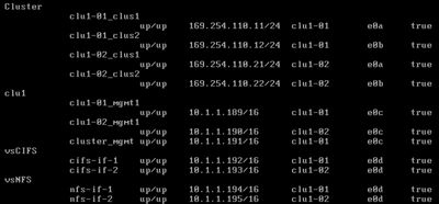

I have setup ONTAP 8.3 simultor in cluster mode on ESXi 6.5. Below are the network interface details:
AFAIK, I should connect to cluster_mgmt  but when I try to ping it from my laptop, it doesn't work.
What am I missing here ?

jcolonfzenpr
5,478 Views
Try to move the cluster_mgmt to port e0c
network interface modify -vserver clu1 -lif cluster_mgmt -home-port e0c
hope this help!

sudhirchamp2005
5,468 Views
Thanks for your response.
I executed the command that you gave me.
Now it shows as false.
jcolonfzenpr
5,464 Views
try to move it to home port.
network interface revert *
https://docs.netapp.com/ontap-9/topic/com.netapp.doc.dot-cm-cmpr-950/network__interface__revert.html
Jonathan Colón | Blog | Linkedin
sudhirchamp2005
5,455 Views
Looks good now. But I am still not able to ping it from my laptop.
jcolonfzenpr
5,446 Views
can you ping the other mgmt IPs (189 & 190)?
if yes, maybe there is a IP conflict with 191 IP.
  • try to test it assigning other IP
else no, try to verify your laptop network configuration.
sudhirchamp2005
5,436 Views
I am not able to ping 189 and 190 as well . Looks like that the network route has to be modified. I am using VPN. Is it possible to change all the 10.1.* IP's to 10.100.*
I am not able to ping the gateway as well.
Can I change the gateway as well  to the one that is reachable via my laptop?
