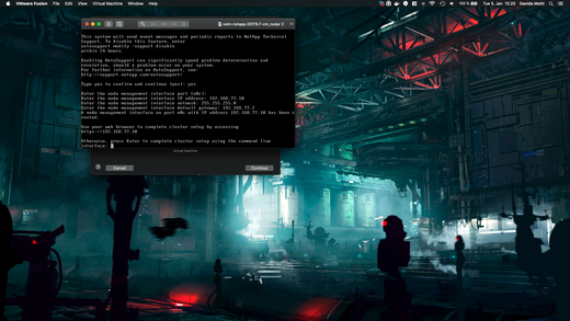

I am trying to run the ONTAP 9 Simulator but I cannot access the GUI. I will provide you all the details.
Virtualizer: VMWare Fusion 12.1.0
ONTAP: vsim-netapp-DOT9.7-cm_nodar.ova
I have followed what is explained in this guide https://community.netapp.com/fukiw75442/attachments/fukiw75442/simulator-discussions/2079/1/ONTAP-Sim-Getting_Started_Quick_v10.pdf but when I enter the username and password I am told that the credentials are not correct.
Here are the steps I followed:
* Import the ova in VMWare
* The VM boot and as described by the guide, I press CTRL-C in order to get the the boot menu
* At the boot menu I select the Option 4 "Clean configuration and initialize all disks"
* During the reset process no errors are reported, the VM boot again and I am asked to enter the following parameters:
IP: 192.168.77.10(as described in the guide I look with ifconfig at the vmnet8 interface)
Netmask: 255.255.255.0
Default Gateway: 192.168.77.2
Then comes that the rest of the config can also be finalized at https://192.168.77.10, but with the admin default credentials (https://library.netapp.com/ecmdocs/ECMP1148877/html/GUID-3954F916-F50C-4A41-83AB-61BE1C38854B.html#:~:text=You%20should%20be%20logged%20in,the%20passw...) I cannot go on, so I continue the configuration on the Console with:
* create cluster
* single node cluster
* set admin cluster node password
* cluster name
* Additional License Key (according to the instructions it can be left empty)
* domain name (according to the instructions it can be left empty)
* Where is the controller located (according to the instructions it can be left empty)
* system config backup (according to the instructions it can be left empty)
Then on the screen it is reported that the GUI can be accessed at https://192.168.77.10, so I give admin as username and the password that I have just created but no way to get into the GUI.
With the credentials that I created I can log into the Console and per SSH but not into the GUI.
With security login show I can see that the admin user can authenticate over all the protocols (see screenshot).
I have tried to set up another user, with admin role and authentication over HTTP + SSH + ONTAPI + CONSOLE but the result is always the same, Console and SSH is ok but the GUI not.
I also tried to set the License Key as described on the guide, everything works as described until the moment where I want to log into the GUI, here I always get "Login failed verify username and password".
Could you please provide some advice/idea?
Kind Regards,
Davide Motti

Hi, thank you for the answer.
The Gui that I try to reach is the GUI that ONTAP Install suggest to open in order to complete the setup (http://192.168.77.10).
The network configuration is setup as described on ONTAP-Sim-Getting_Started_Quick:
IP from vmnet8: 192.168.77.10
But with username: admin and pwd: netapp!123 as in your guide described it says that the credentials are not correct:
However with this credentials I am able to log into the CLI:
And this ist the output of the command that you requested:
P.S. I started my post with "cannot access the GUI" because this is my problem, I cannot access/log into the GUI. Over the CLI I can create users, cluster and so on, but I am not able to log into the GUI.
Thanks in advance.
