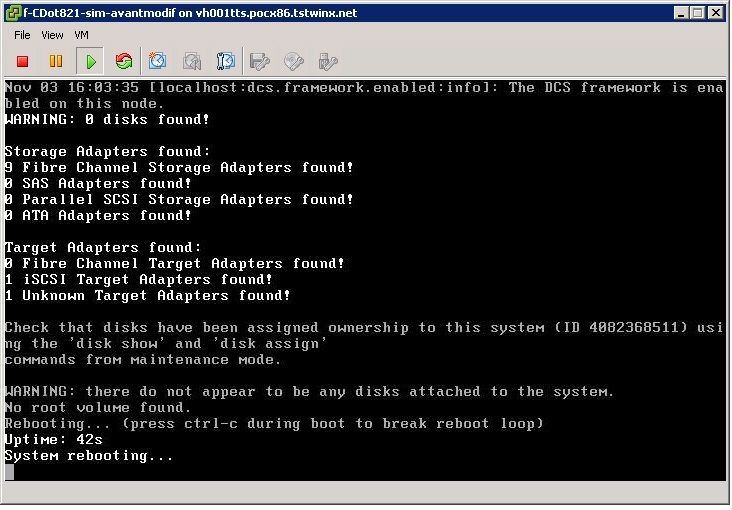

Hi all, I'm trying to run the simulator on ESXi 5.1U1.
The pb is the filer do not see its disks. I tried
- without files modifications, just enterring : vmkload_mod multiextent, adding to Vsphere inventory, then start.
- with files modification using theses commands, then adding VM to Vsphere inventory, then start, as stated here : http://community.netapp.com/t5/Simulator-Discussions/ONTAP-Simulator-Fixes-MEGA-Thread/td-p/11213

See joined pic Does it means this simulator is not compatible with vSphere 5.1 ?
Thank you

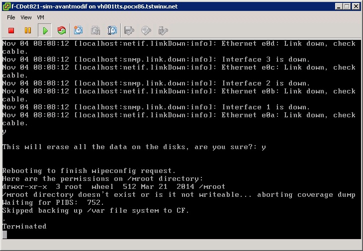

Hi,
Thank you for this suggestion, but it does not work :
shatfield
7,052 Views
Does it bootloop again after the option 4? (the first reboot is expected).
If so, something happened during init that prevented the simdisks from being created.  To confirm, Ctrl-C to the boot menu, then ls /sim/dev/,disks
if the directory is empty, you need to rearm vdevinit at the loader:
Reboot, stopping at the LOADER> prompt, then enter the following:
setenv bootarg.vm.sim.vdevinit "23:14:0,23:14:1"
setenv bootarg.sim.vdevinit "23:14:0,23:14:1"
boot
Then Ctr-C, option 4.  You should get a reboot, then a wall of dots, then the setup script.

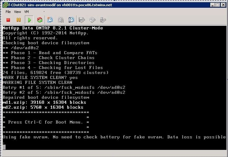

Hi
Thanks to all of you.
In fact, after option 4, there is an error, but after reboot, I can see the wall of dots, and the cluster wizard is automatically started.
Best regards
