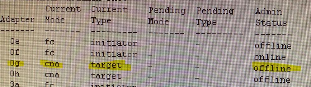

Hi All,
I have converted a qlogic cna 8324 (8362)  from FC to CNA but i see the port status showing ofline.
May i know what is the configuration needs to be done on the switch side ? To support the CNA type.
Ontap :- 8.2.57Mode
FAS8040
Thanks in advance.

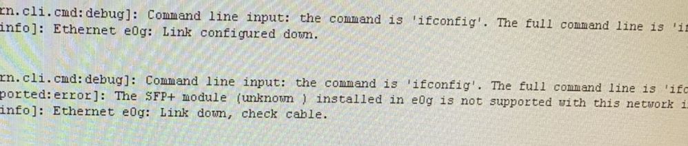

mjdalton1
8,222 Views
I think you want
ifconfig e0g  up
ifconfig e0h up
May want to confirm SFP is 10GbE as well.

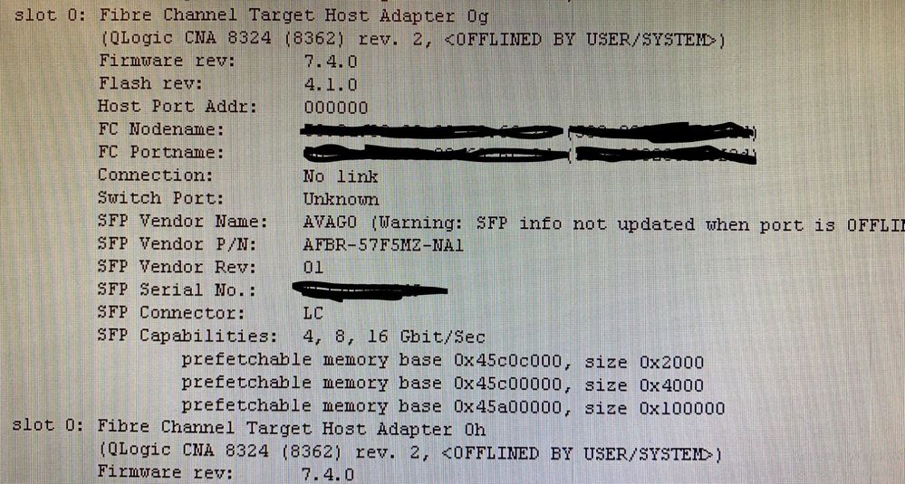

NAYABSK
8,137 Views
SFP on the Netapp side showing it supports 4,8 and 16GB speeds (Last screenshot in my post) . Whereas my switch side is a 10Gb SFP If this is the case i cannot use it because the switch end SFP is 10G ?
Pat_Parent
8,116 Views
Hello NAYABSK,
When you use a CNA, you are working with Ethernet speed (10GBPS). The speed on the SFP of 4-8-16 GBPS is FC speed. So my guess is that you have the wrong sfp in there.... Do you want to do FCoE with your Setup ?

paul_stejskal
8,077 Views
Yes you need to use an approved SFP. If that's not a 10Gb SFP it won't work.
